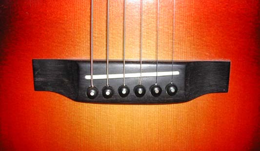

Hey Hesh, how about this for your L-00?   That my early '30's L-00. Square
and simple with a nice re-curve on the wings!
And here's one of mine...
[IMG] http://www.freilicherguitars.com/OLF/bridge/mybridgeprofile. jpg[/
IMG]
Louis

Thanks Hesh!!
I'm not sure why the other photo is not loading. I think the system hates
me!
My L-00 is from 1932-1934 and all original except for the neck block has
been slipped to correct a low neck angle. The repair is functional but a
bit ugly of you look close. On the plus side it dropped the price about
$400 when I bought it! I'll post some more pics in a new thred for you.
Louis

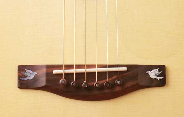

Here's mine, with addition of the dove inlays on the bridge wings. I have also done several bridges shaped as the dove descending in the soundboard, but can't seem top find a photo of them. They ended up on guitars used in the music ministry at several churches.
Hank Mauel

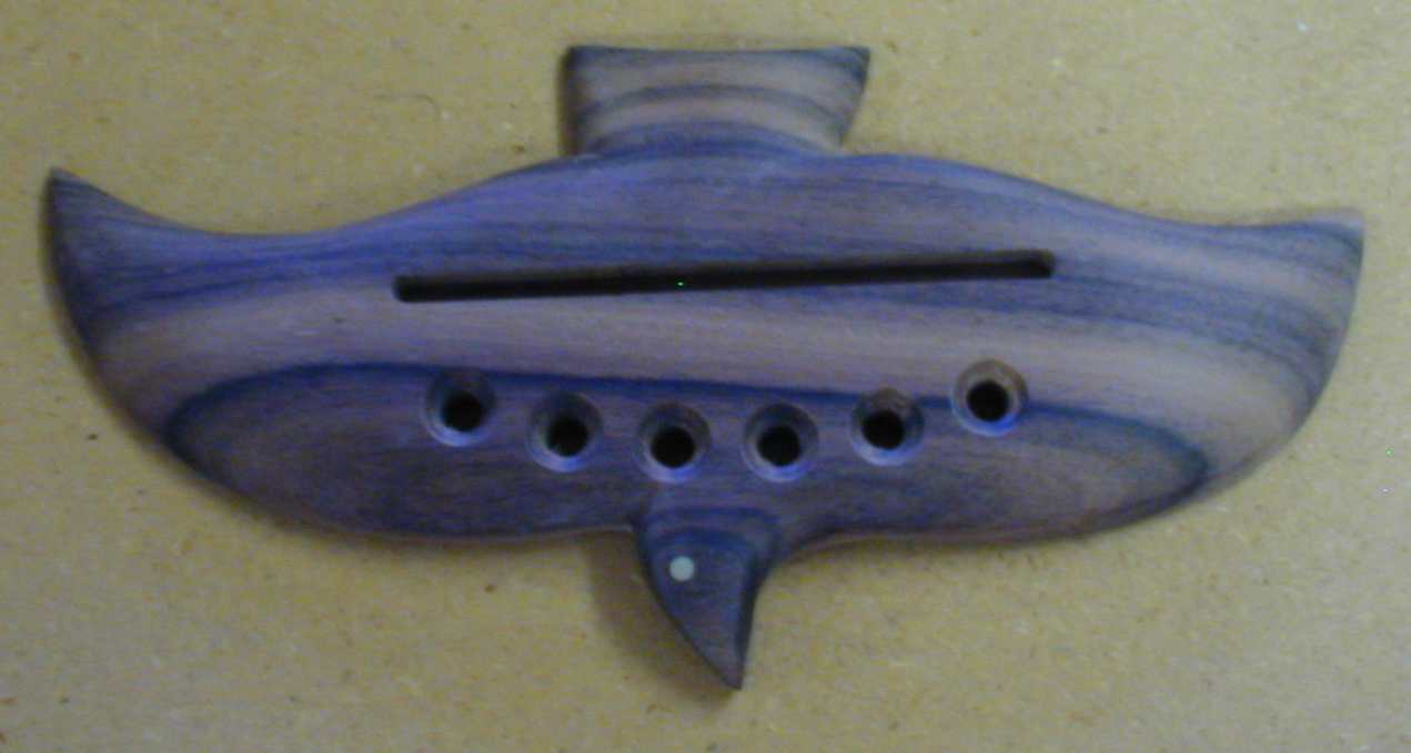

Oooh, Oooh, I found the dove bridge. Not a good pic, but you get the idea.
Hank Mauel

Sorry but it looks like a seagull to me.

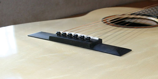

Kickin' it old school! Classical-inspired rectangular design with rounded over wings. The top of the bridge is slightly "radiused" like the fingerboard with the pinholes parallel to the slant of the saddle.
Warren
